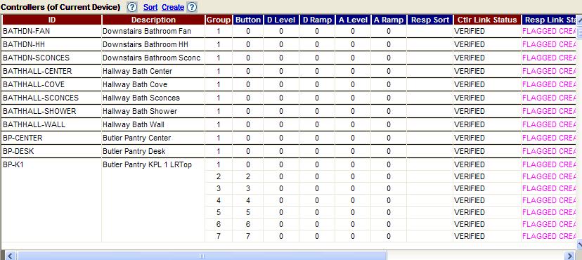

| Posted: January 18 2010 at 12:44 | IP Logged
Lee - Thanks for the info, I followed your comments carefully while looking at my PLM links.
The easier one, Controllers (of curent device):
* I have an entry for each KPL, and every other device.
* Every device is in group 1.
* Every KPL is in group 1-8.
Question:
The button column - for all my devices have a 0 - looks OK. For all my KPLs that got "automatically added" it is 0, for some that I added manually I had to specify a number from 1-254. I simply made the button column equal to the group column - is this OK? You can see this in the snapshot: BP-K1, where button 1 was automatically added, and I had to manually add 2-8. For KPLs only, should I retrofit all my 0 button entries to reflect the group number?

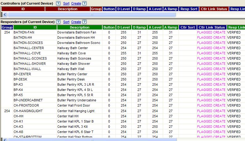

The harder one, Responders (of curent device):
Everything seems to fall under one of the following:
* KPL buttons that share a group,
* KPL buttons that have their own group,
* Devices that reside in group 254,

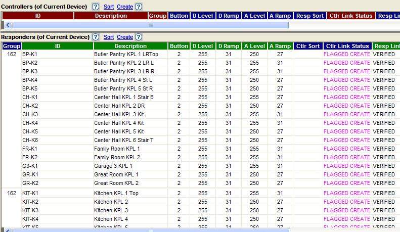

* "Specialty" groups, like group 162, which has all KPL buttons #2. This is for controlling KPL button status via the PH.InsteonGroupCU command. I have groups 162-168 for buttons 2-8 respectively.

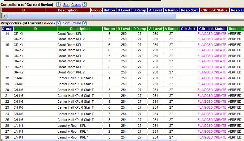

* I also have some groups for controlling random groups of KPL button status, via the InsteonGroup command (the concept that Lee gave me recently).
As you can see from the snapshots:
* I have KPLs in groups of 2 (group 14-17), or indidividual (group 18-28) - looks ugly.
* Group 162-168 is OK,
* Group 254 looks OK.
My big unknown is "What do I really need"? To sort this out, do I only need:
* Group 254 for all devices, including an entry for each KPL with button 0 (as seen for BP-K3, BP-K4, etc).
* A group for all KPL buttons, like I have for 162-168 (I would add a 161 for button 1).

* Eliminate all the other groups.
* Thats it?

| Posted: January 18 2010 at 14:03 | IP Logged
I will go through your last post in detail but to respond to the first question, do not change the existing button 0 value to something else. I think the value is ignored so setting the "Controllers (of current device)" responder device button number (blue column) to the KPL button number is not necessary. In fact with the PLM as a responder for these links I would have thought PH would allow a 0 button number. I will test that here. More after I have reviewed the screen capture data.

| Posted: January 18 2010 at 16:17 | IP Logged
Regarding the original question, button 1 will be okay. The button number in a responder link record ("Controller (of current device)" blue column identifies the Output Unit number which is 0 for all Insteon devices that I am aware of except a KPL. The actual responder device type (PLM) should be controlling, not the type of controller device. PH should allow a 0 button number but it makes no difference here because the PLM is a programmed device and really does not care what the Output Unit number is. If the responder device was a SwitchLinc for example, the SwitchLinc hardware requires the button number be 0 for the value that goes into the responder link record.
As for the PLM "Responders (of current device)" (except for 254) Group numbers and how many there are is based on what you decided you needed. If the Group numbers are being used in ph_xxxxx commands, then the definitions are needed. If you are not using the Group numbers they can be deleted. Normally you would not have a single device in a Group definition as you could do the same processing with an Insteon Direct command. Since you are using the technique of sending only a Group Broadcast command to a Group, which requires no ACK and therefore no guarantee it worked, you probably need to keep these.
I don't know why you have the Group 254 definitions. I have no 254 Group. Are you using Group 254 in any of the Insteon commands being used?

For the PLM - yes, I did have a red shaded clear failed, there were also about 6 other devices with that. I cleared the fail, and did a refresh, all the pending operations completed - all is clear. Great!
For the links - just to be sure:
Controllers:
* Leave alone everything here - all looks OK.
Responders:
* I shall remove all the groups that have one KPL individual button in them Groups (14,-28 etc).
* Keep my specialty groups (162, etc)
* Keep 254 - it seems to receive any new device I add. I will continue to experiment/observe.
Thanks!
| Posted: January 18 2010 at 22:28 | IP Logged
Yes, leave the Controllers as they are.
See my post before your last post. If you are using the single KPL button Groups for LED control, leave them as they are. Otherwise you can delete them. There are ways to control the LEDs with Direct commands but the way KPLs are changing revision levels that technique may not be stable. Using Groups is the way KPL hardware does it so that technique will always work.
I don't know why your devices are being added to Group 254 but since it is only a single Group I see no harm in leaving it alone.

I'll delete the other one-off groups. That will clear up alot and give me more room for the KPL status button groups. Before I blast away all the groups, I'm interested to test how the PH status works before and after one or two changes.
