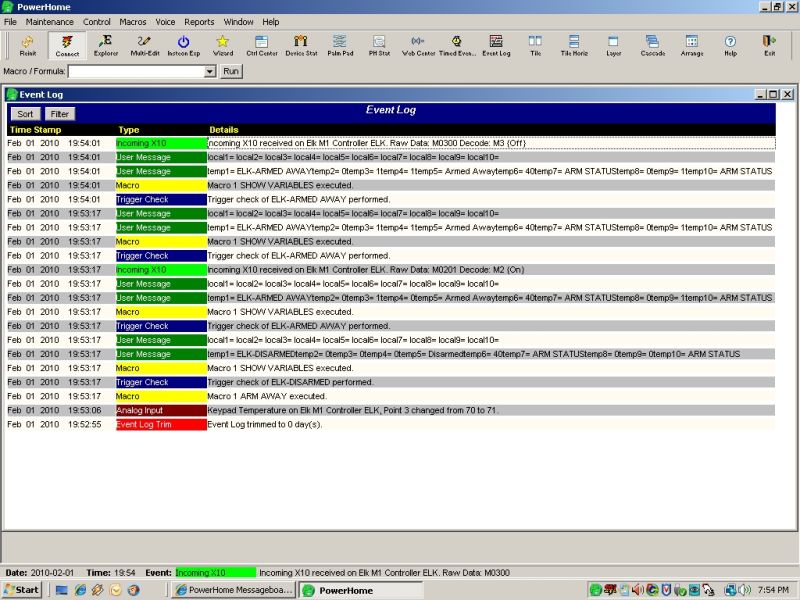

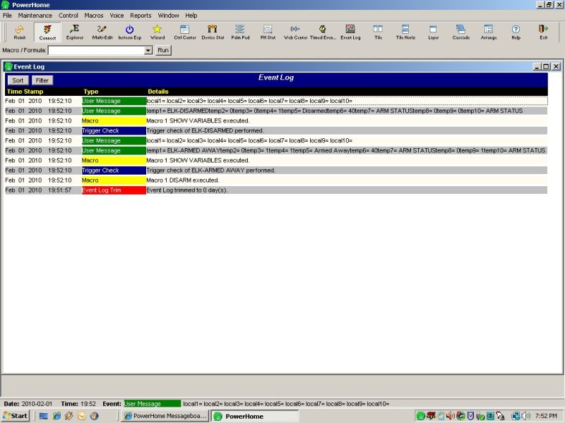

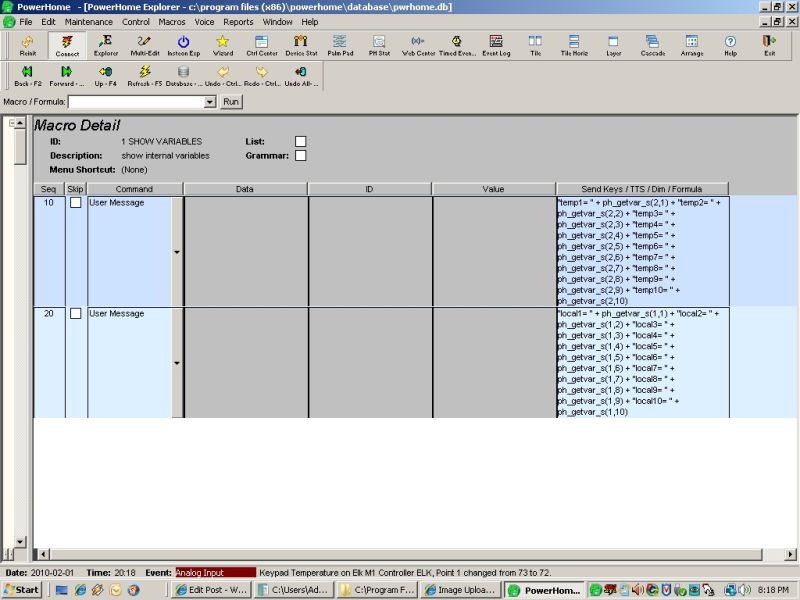

Ok, let me walk through this. Here is the event log when I perform an "Armed-Away" command =>ph_ctlrsq("ELK",121,"00XXXX",1,1):
Now, here is the log file (after I cleared it) from the "Dis-Arm" command =>ph_ctlrsq("ELK",121,"00XXXX",0,1)

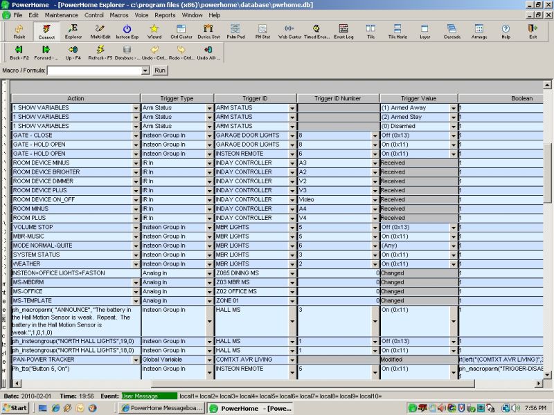

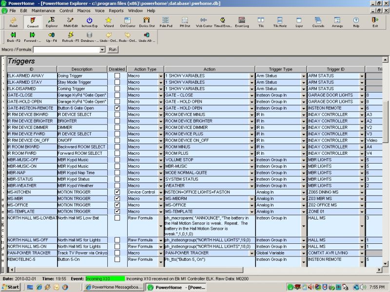

Here are my Elk triggers:

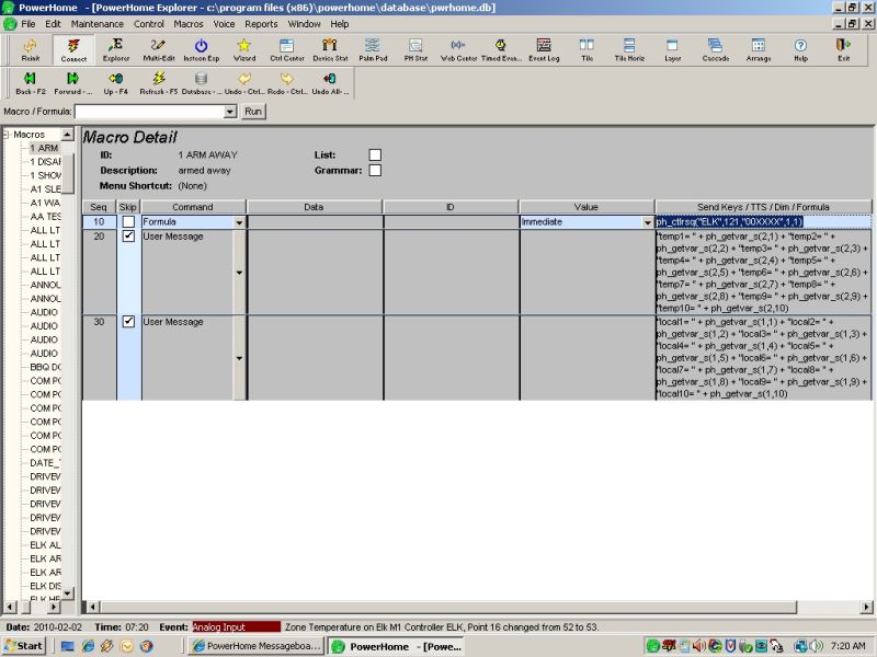

Lastly, this is the macro that the Elk triggers call. I believe this is what you (Dave H.) are referring to when you say "DISPLAYVARS"....right?
By the way, the above results were ran on a different machine from my main system (trying to see if it made any difference). Also, I performed a "phupg.exe" database validation prior to running these results.
It still appears to me that my Elk triggers are not behaving as they should.

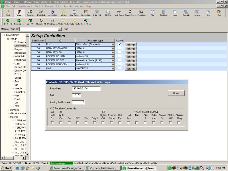

My Elk controller setup (ethernet) is shown here:
I am stumped. I am running the latest M1XEP firmware, Vista is fully updated etc. It appears that the duplicate trigger tghing has been plaging me for quite some time (finally got around to really studying what is happening). Ideas???

The first ELK_ARMED AWAY at 19:53:17 is for Area 0 (temp4=0)
The second ELK_ARMED AWAY at 19:53:17 is for Area 1 (temp4=1)
The third ELK_ARMED AWAY at 19:54:01 is for Area 1 (temp4=1)
The third trigger is 44 seconds after the second.
Which of the ELK_ARMED AWAY triggers are you looking at as being a duplicate?
With ELK communication being IP on a specific port you may be able to monitor that specific port traffic using DockLight free download.
If you want to wait for Dave to respond that is fine with me.

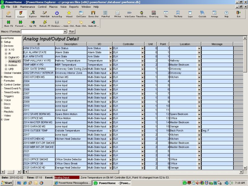

Can you post some screenshots of your Analog I/O configuration where you've defined the Arm Status points?
Back to Top View dhoward's Profile Search for other posts by dhoward Visit dhoward's Homepage

However, upon very close inspection of the last event log shot, I can see Macro 1 Disarm executed which appears to trigger ELK-ARMED AWAY (which doesnt make sense) followed by a single trigger of ELK-DISARMED. So in this case, not a duplicate but also very strange behaviour. It might also make sense to post screenshots of your 1 DISARM and 1 ARM AWAY macros to see if anything is up there.
Haven't messed with these in ages....
Arm and dis-arm macros:

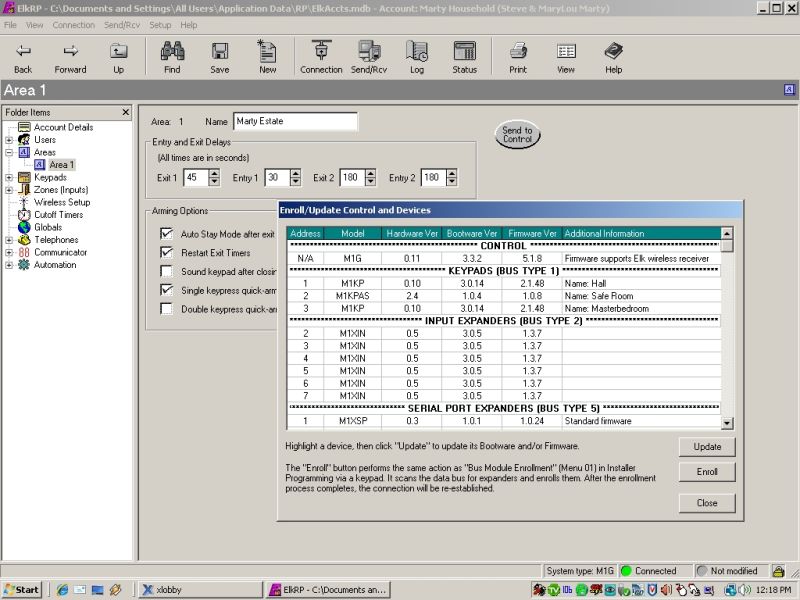

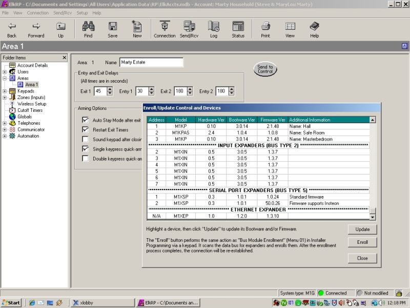

Hmmm....so I see I am not the only one who sees duplicate arm/disarm triggers. Gibbage, what version of main board and XEP firmaware are you running. The following two screen shots show my Elk firmware for both the main board and the XEP.
As can be seen, I have the latest firmware for the XEP, but I still need to upgrade the bootware and firmware for the main panel...Will do that tonight. New Elk release notes have a number of ASCII protocal corrections....maybe this will help???

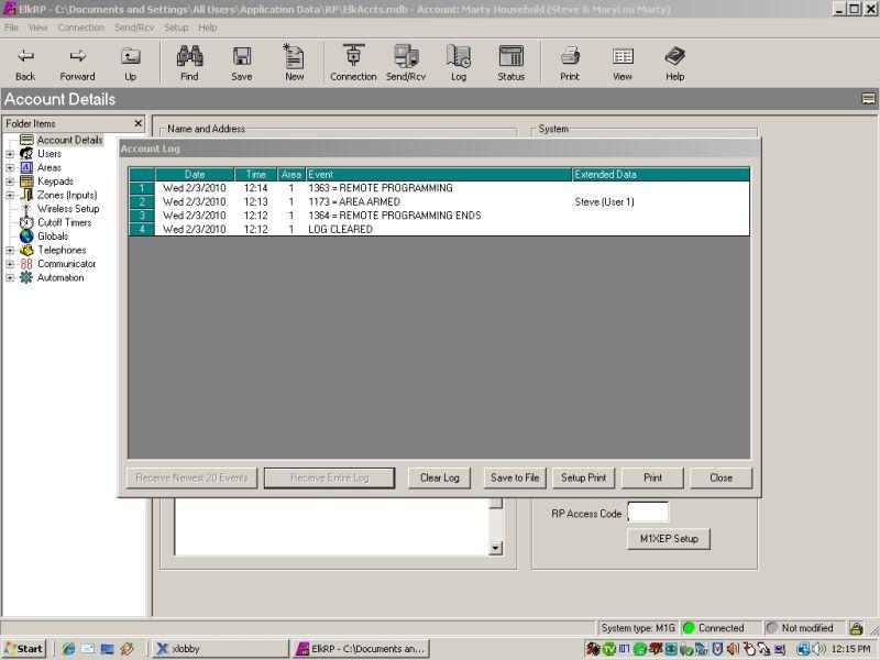

The image below shows the ElkRp log file for when I "Armed-Away" my system. It appears OK to me (no duplicate triggers)

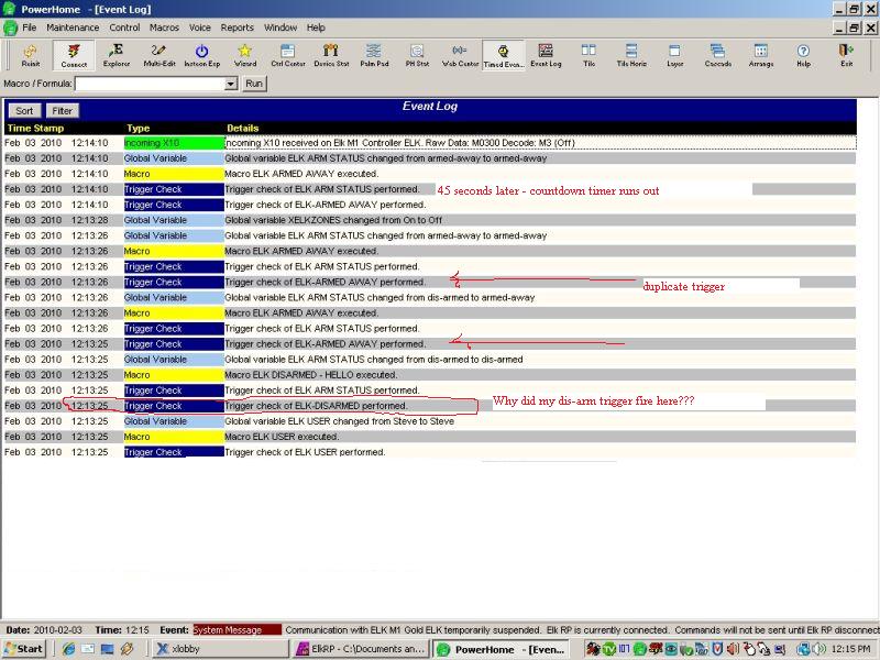

The corresponding PowerHome log file shows two disturbing things....duplicate triggers, and also a "dis-arm" trigger firing (when the system was set to "Arm-Away").

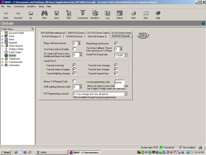

Here are Elk Globals...I think these are right????
