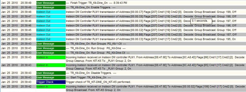

Proper behavior on Jan 25:
Jan 25 20:39:42 KPL button pressed,
Jan 25 20:39:43 Trigger starts,
Jan 25 20:39:43 Disable triggers,
Jan 25 20:39:43 Run (3) PH.InstronGroup commands, affecting (7) groups,
Jan 25 20:39:43 Execute PH.Delay(6000),
-- the groups react, and complete, which takes just under 6 seconds.
Jan 25 20:39:49 Wait period expires,
Jan 25 20:39:49 Enable triggers,
Jan 25 20:39:49 Code completes.

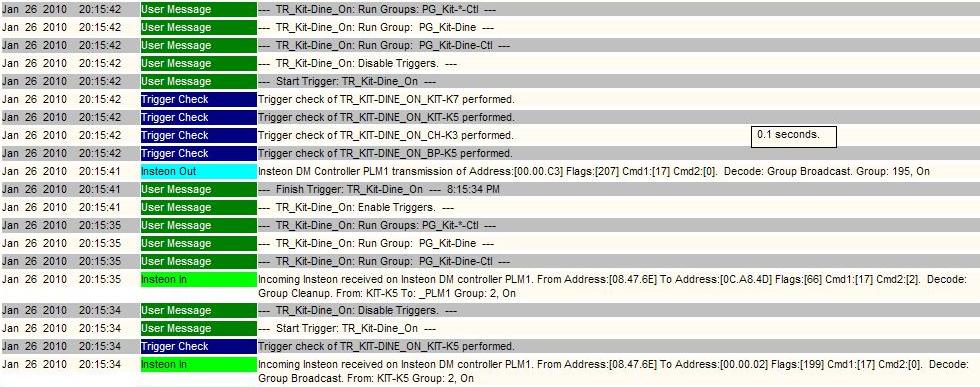

Bad behavior on Jan 26:
Jan 26 20:15:34 KPL button pressed,
Jan 26 20:15:34 Trigger starts,
Jan 26 20:15:34 Disable triggers,
Jan 26 20:15:35 Run (3) PH.InstronGroup commands, affecting (7) groups,
Jan 26 20:15:35 Execute PH.Delay(6000),
Jan 26 20:15:41 Wait period expires,
Jan 26 20:15:42 Enable triggers,
Jan 26 20:15:42 Code completes.
-- the groups react, which took over 6 seconds.
Jan 26 20:15:42 The triggers associated with those KPL buttons start.
-- This causes an endless process of execution.

Jan 26th (Good):
Jan 25th (NG):

Jan 25th (Good):
Jan 26th (NG):
