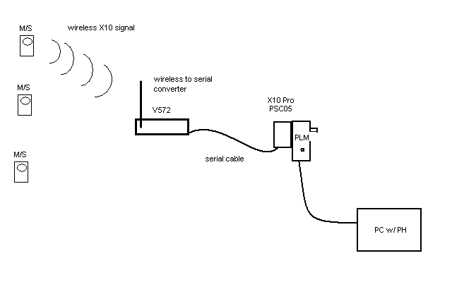

I am using a WGL Designs V572RF32 transceiver with Powerhome to pick up RF X10 motion sensors (mainly MS13A motion sensors).  The V572RF32 transmits to the powerline with the supplied PSC05 unit piggybacked directly into a Smarthome Powerline Modem (2412S) (PLM).  This has been great for over a year.
 For the last few months I have been having a problem with my incoming wireless X10 commands.  I mostly am getting the house/unit code without the ON/OFF command, or visa versa.  For example, a normal incoming X10 command appears thus (in the PH event log, not the raw log):
 Incoming X10 received on Insteon DM controller PLM 2412S. Byte Values: 7E 00  Decode:  I2
 Incoming X10 received on Insteon DM controller PLM 2412S. Byte Values: 72 80  Decode:  I{On}
 Mostly now I am just getting one line or the other, but not both.  Is this something anyone has seen before or have any idea what could be the cause?  Warren, the WGL transceiver designer thinks it could be a software issue.  Does anyone know of another (hopefully free software) product to see if the incoming X10 messages are still clipped?

How could (presumably powerline) noise be an issue?  The signals are RF and the tranceiver/powerline interface is piggybacked onto the PLM.  I suppose there could be some sort of RF noise, but I doubt it.  The only RF signals in my house that I am aware of are the motion sensors and my wireless network hub.  I think it is either the transceiver/powerline interface(PSC05)/PLM/or PH.  If I can duplicate the half messages with some other software, I can eliminate PH.

Picture is worth a thousand words. Your right, this basically narrows it down to PLM vs PSC05 vs V572. Have not heard of this type of problem because of the PLM. I receive both types of signals without a problem. Finger pointing sure makes the V572 suspicious. Did you filter any of the HC/UCs with their software? Have seen a cable cause an intermittent failure because a cat bit it once.
 Can you test with the motion detector for single shots to see if they fail? I do this by placing my hand over it so it doesn’t fire then I release it and then cover it. I am assuming you are getting multiple shot with the same motion.

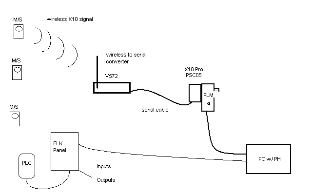

 I have attached another system diagram so you can see what else I have.  I do have a PLC attached to the ELK security/fire panel.  Originally this allowed standalone operation w/o a 24/7 PC, but just wasn't powerful enough for me once I got sucked into this HA morass!  The problem is that the PLC just passes on light changes to the ELK and turns on/off lights per the ELKs onboard programming - it doesn't really forward those changes onto the powerline.  There is probably a way, but you might have to suggest it to prompt me.
 ****Are all the motion sensors using the same X10 address or are all these messages coming from the same motion sensor. ****
 All the motion sensors have their own house code, though generally the same unit code (P2/G2/J2 etc.)
