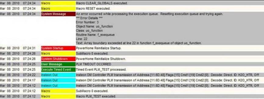

Anyone seen this?
The sequence of events occurred because of an apparent PLM failure. I have a set of routines that monitors the status of the Insteon network. If the PLM appears to hang, as Jeff will attest will happen, then I do a ReInit. The failure is a result of doing the ReInit. What most likely would have been in the Execution Queue at the time of the ReInit was probably a macro running PH_GETINSTEONLEVELRT commands.
