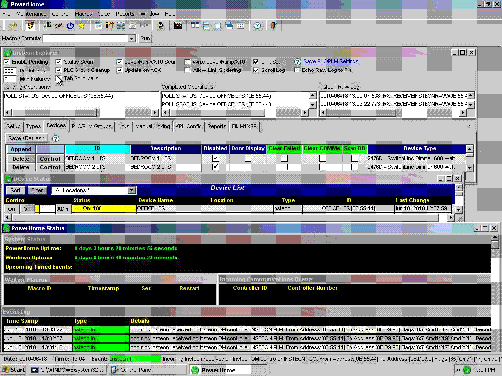

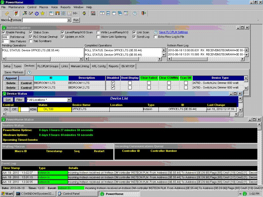

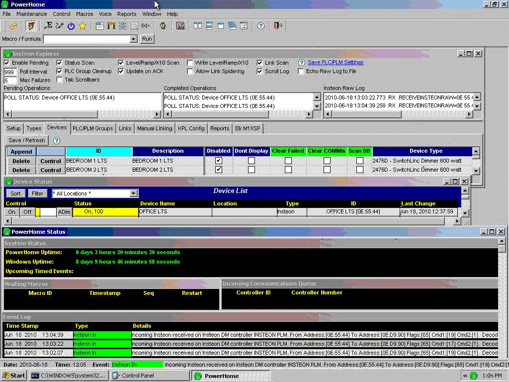

Here's some screen caps, blame Avocent and a 150K image size restriction for the poor video, sorry.
Here, I just pressed OFF on the wall switch:
Here, I just pressed ON (so technically Device Status is correct, but see the timestamp, it's old)
Here, I just pressed OFF again on the wall switch:
No other events, no other Insteon traffic. See, the event arrives, is decoded correctly, shows up in the Event Log, and never makes it to Device Status. I'm asking WTF and would really appreciate some clues as to where to check next. My experience with PH devices and Insteon is that PH just automatically picks them up, once created by Insteon Explorer, and just magically makes them work right within the Device Status and PH database. So I don't know what broke or why. The system hadn't been logged into for at least a month when it suddenly stopped working one day, and no Insteon changes had been made. I'm at a loss as to what to try next.

The Event Log is not showing any Group Broadcast messages, only the Group Cleanup Direct messages. That suggests the PLM links have been corrupted in some way. The links are required so that the non-device specific Group Broadcast message is accepted by the PLM. Try rebuilding the PLM link database.
