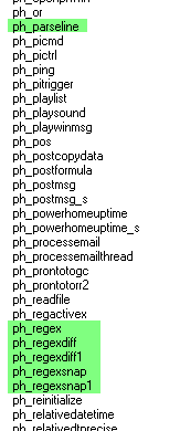

Then I discovered the PH string functions (highlighted in
green in the Help file Index list)
These powerful PH functions provide almost unlimited
string location and extraction functionality from a
target string.

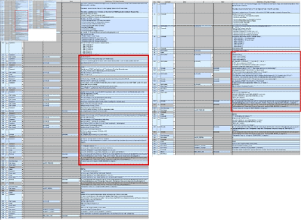

The differences between my old and the new methods are
noteable, with the "old" on the left and the "new"
on the right in this image . . .
The areas boxed in Red are the actual data extraction
code, the rest is setup and validity checking.
Highlighting just the extraction code more readily shows
the greater efficiency (not to mention ease of
development effort) of the PH built-in capabilities.

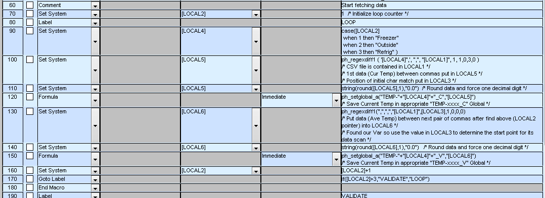

Here is my little bit of Code to extract the three sets
of temperature data from the CSV file.
Note, to get the file into PH, in order to parse it, the
following function was used . . .
This reads the entire file's contents into the local
variable [LOCAL1], where it can then be used.
The code to extract the data is done in a loop that grabs
each line in turn . . .
Using the Case function to extract a search label for
each loop pass (LOCAL2 is a loop counter incremented on
each pass), that label is then first looked for, the data
value just following it is extracted, and a index pointer
is set marking the end of that first data in the string,
so that a simple comma delimited data snap of subsequent
data can then be performed. Since the ph_regexdiff1()
function uses a search starting pointer, setting that
pointer allows one to skip over the initial portion of a
data line. Note the function also contains an "incident"
counter so that once the beginning of a repeating pattern
(ie, data between commas) is identified, the nth, nth+1,
etc data set can easily be grabbed.
Explaining the ph_regexdiff1() function as used, we have
for the function's Syntax . . .
ph_regexdiff1 ( pat1, pat2, data, start, occ, flags, localstart, locallength ) |
and an actual use example of . . .

We now have snapped out the "-0.96" data element for the
Freezer, from the CSV file.
To get the next temperature in this line, we use this line of code . . .
This is simpler than the first snap effort, as we are
only looking for the data between commas now.
The orange boxed parameter defines a comma for the pre-
snap match string, and the green box the post-snap match
string. We will snap everything in between those
parameters from the contents of the LOCAL1 variable.
Since LOCAL3 was set to the initial character of the
previously snapped data, we know we are past prior commas
and that the next comma delimiter set we find will be
associated with our next desired data set.
NOTE: that looping on this expression but incrementing
the occ parameter (the "1" following the "LOCAL3"
parameter above), would let us parade right down the
comma delimited data string capturing each data element
in turn.
