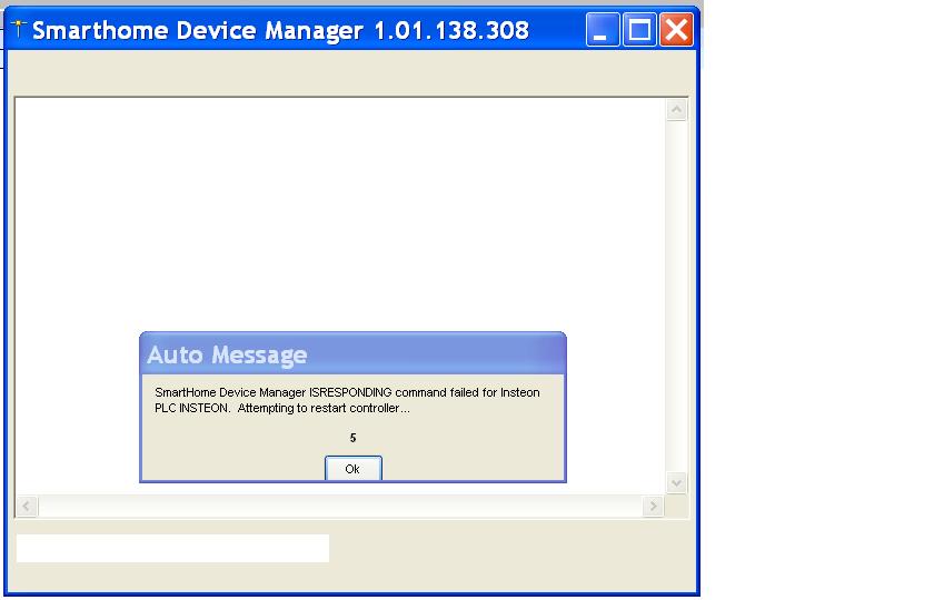

I carried on, powered up the modem, plugged it into the COM port, and Windows doesn't detect it. No info what to do if it doesn't, so I move along. Start up PH2 and see what happens, a error window keeps popping up so often it almost prevents me from trying anything, but as annoying as it is, I eventually get to the PH2 Wizard and add the Insteon controller. There is no option for my controller model 2413S only a 2414S so I choose that one. Eventually it shows up in PH.. the REALLY annoying window keeps popping up every 3 seconds, and needs to be clicked on before I can go back to what I am doing.
Moving on to a module. I plug in the 2457D2 LampLinc, it functions as it should, and using the buttons on the side can control the light.. woohoo! Back to PH, can't stop the REALLY REALLY annoying message, so exit everything and here I am.
I am not the most patient person when it comes to things that make the consumer have to go out of their way to find additional instructions, and you gotta love the link to the Owner's manual.
http://wiki.smarthome.com/index.php?title=2457D2_Manual what company does that?! Jeeze, they really should try a link shortening system!
Any how, so to rant, but I am not the least bit impressed with Smarthome at this moment. Can someone please tell me what's going on? Below is a image of the error that just won't stop.

The SDM3 Device Manager is not used with any variant of PLM, only a 2414 PLC. There are no special drivers needed for a 2412S or 2413S Serial PLM. The 2413S Serial Dual Band PLM is functionally equivalent to the 2412S PLM which is the Device Type that should be used.
The Dual Band PLM does support less total links in the PLM itself but all the commands to interface with a PLM are the same between a 2412S and 2413S PLM.

Ok, not sure what you are telling me here. Are you saying I have the wrong device? As for drivers, I just followed the instructions provided. I have no idea where to go from here because I can't tell if it is talking with PH or not.

Brian, just define it in controllers as Insteon PLM. Make sure you get the COM Port right. There are no drivers as they are supplied by MS. In Devices I have it defined as 2412s.
| Posted: February 15 2011 at 09:52 | IP Logged
Yes, you picked the wrong device type.
Change the device type to 2412S PLM as that is functionally equivalent to a 2413S PLM as far as the PLM function is concerned.
When the 2414S PLC device type was selected it causes PH2 to use the SDM3 Smarthome Device Manager. SDM3 knows nothing about a PLM, only a PLC. Very different devices with very different interfaces. The 2412S and 2413S PLMs do not require special device drivers as they use standard Serial Port protocol so do not be concerned over device drivers you installed. Nothing regarding a 2412S or 2413S PLM should have indicated a need for device drivers. If something directed the install of device drivers it could be the instructions for a 2413U PLM (USB variant).

Wow, ok Beachbum was right... I think. Setting it to
2412S stopped the errors, and PH seems happy.
