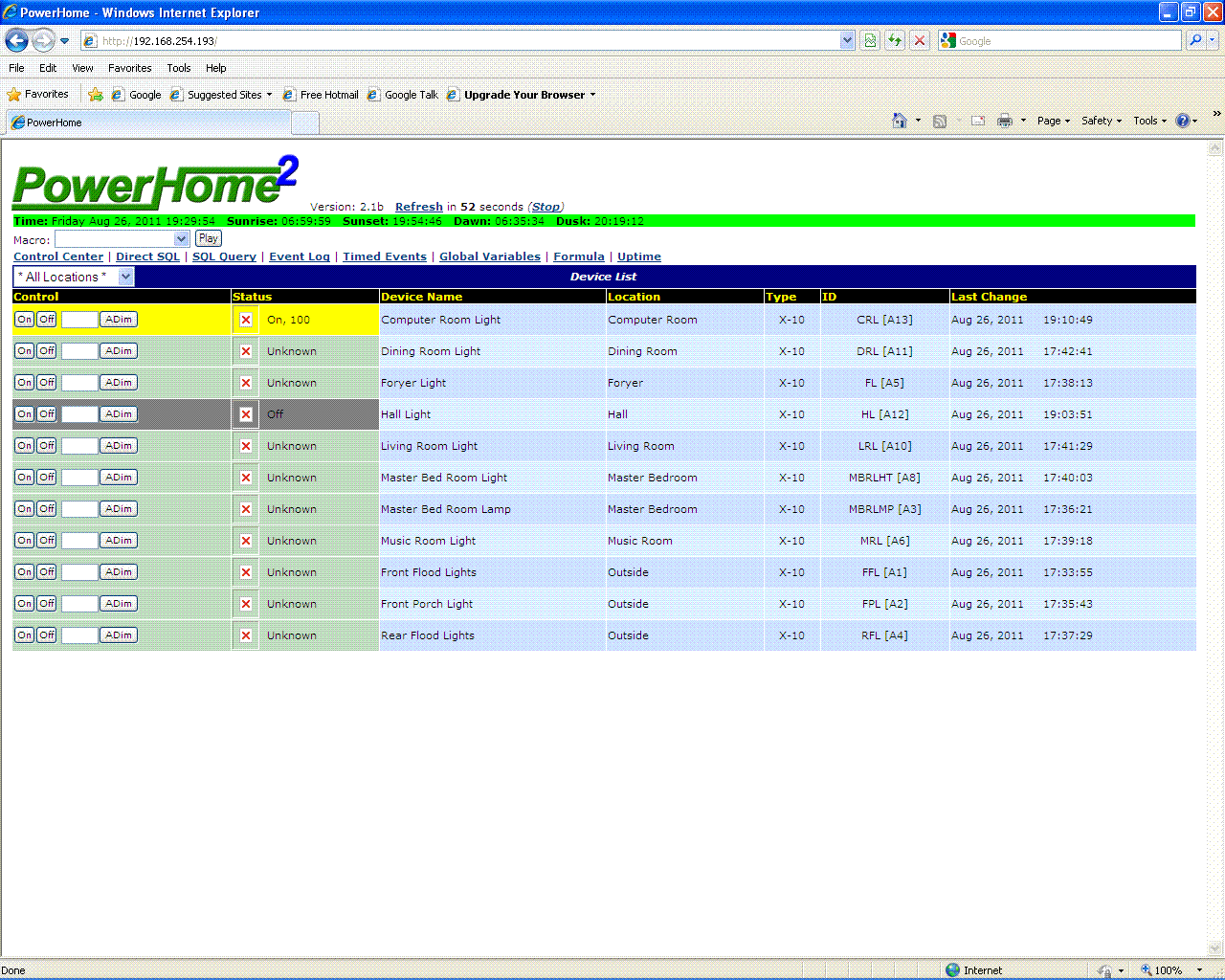

 I'm just starting to play with the built-in web server and I've ran into a strange one. Most of the graphics, like the on.gif off.gif, etc. don't show nor do the graphics on the control center page when I access the web center, even though they're in the web directory. I found a post and thought it was because the path has spaces in it and fixed that but it didn't help. Now I'm wondering if the default install to the "Program Files (x86) directory under windows 7 may be involved.

 Just to clarify, it is the status images that don't show per the image I uploaded. The graphics under the control center are fine as well as the other pages as far as I can tell.

 In PowerHome Explorer, navigate to
 PowerHome|Devices|X10|Types.  Adjust the filepaths for the
 on, off, dim, and unknown status graphics for each type.
 This should get the status working for you.
 Let me know how it goes.

 That was it. Fixed all the paths and now I'm 100% working across the board. I really appreciate your help on this.
