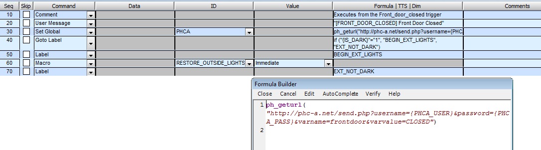

I now see that the word wrapping is inconsistent. Check out this screen shot:
You can see that line 30 is not wrapping but line 40 does. Strange.

Posted: November 20 2011 at 21:18 | IP Logged
Skip,
Adding resizeable columns to PowerHome Explorer is
something I still have to do. I added it to Insteon
Explorer but never got around to PowerHome Explorer.
Concerning the inconsistent wrapping...line 30 is not
wrapped because it is the currently highlighted line for
editing. Change focus to another line and line 30 will
then wrap properly. What is happening is when a line
(column actually) gets focus, it is changed to a single
line edit control for editing purposes (I don't have
control over this functionality...its a function of the
development environment) so will not have wrap. Once the
column loses focus, then it is converted back to an
autosize height display area and will wrap.
Hope this helps,

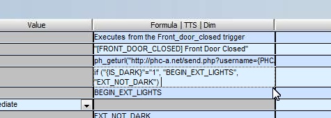

Actually, I am seeing that once a line has decided that it will not wrap, it never wraps,
and conversely, once a line has decided it will wrap, it ALWAYS wraps.
Here, I am editing the the line that is wrapped. I just added a space to the end and you
can see the cursor. Strange.
Anyway, now that I know how to double-click on it to edit it, my life has gotten better :)
