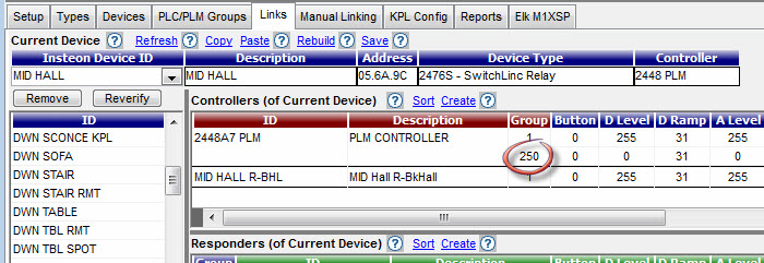

First I defined an Insteon Group I called "ALL OFF" in
the Insteon Explorer PLC/PLM Groups tab. I used a Group
Number for it of 250 as that was unique (for me). That
entry looks like this . . .
Then, using a Timed Events entry that fires at Midnight,
I called a Macro named "NITE-RESET" which has as it's
first command line a Formula using the following . . .
ph_insteongroup("ALL OFF",2019,0)
/* 2000 added to the 19 (ioff) cmd eliminates
group cleanup acks to save traffic */ |
This turns off all lights/devices which have a /PLCPLM
link of 250 in the Controllers (of Current Device) field
The rest of the macro goes around and turns on a few
night lights that I want to keep on.
It was easier to turn all off and then a few back on,
than the other way around!
