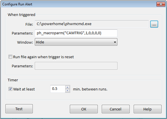

BI can send triggers, on camera motion, back to PH using the BI camera Properties Alert control...
To catch such triggers in PH, set up a Trigger entry...
