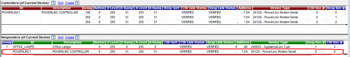

Here is the links for switchlinc.
106 is the Group in question with the switchlinc and appliancelinc.
The other two are my "ALL-OFF Type" groups. 250 being "upstairs off" and 254 is "all lights". They are irrelevant to this test.
The link I have circled from the switchlinc to the PLM. Is this really required for the PLM & powerhome to "hear" the key press or is the fact the switchlinc is in the PLM DB enough?
