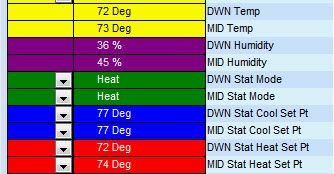

          Here are the STAT starting conditions...
           | Posted: October 24 2014 at 09:39 | IP Logged |   |
 Here are the DWN STAT 2441V responses...
