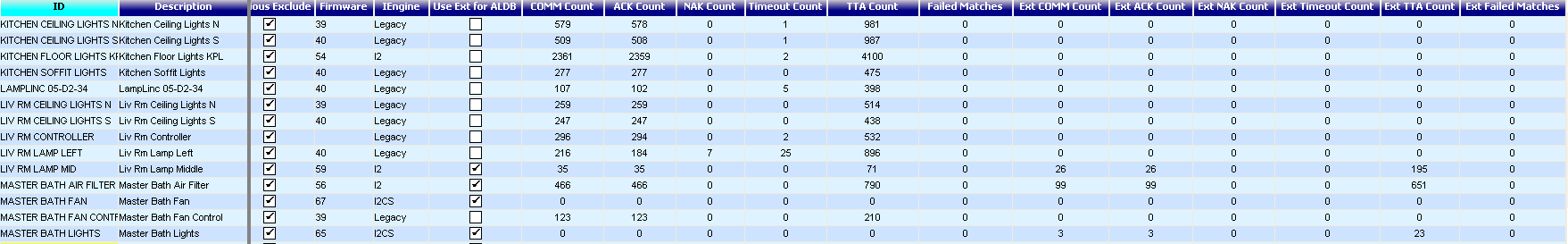

The devices show comm in the "Ext Comm" fields, but not in the "Comm" fields. All of the devices are I2CS.
The Micro On/Off is a replacement for the InlineLinc Relay, but it has more functions. It is a line powered dual band device with two sense wires, a neutral feed, a line feed, and two terminals for loads.

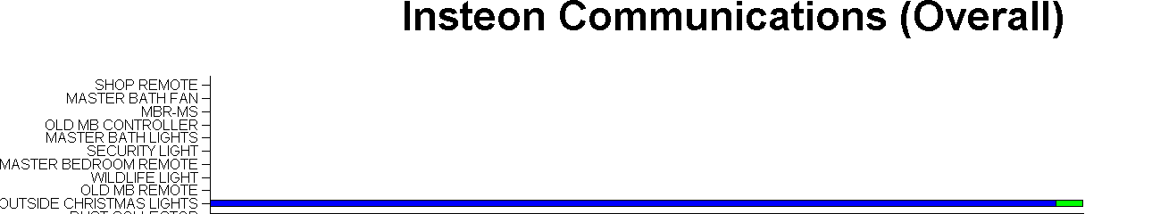

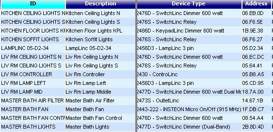

Here are some picts (wide) showing the relevant info for "Master Bath Lights"

Posted: January 16 2015 at 14:57 | IP Logged Quote dhoward
Tom,
That helps alot. Im betting that my reports are only being driven off of the standard comms. Will need to think of a good way to include the extended comms.
I'll let you know what I find out after I go through the code.
