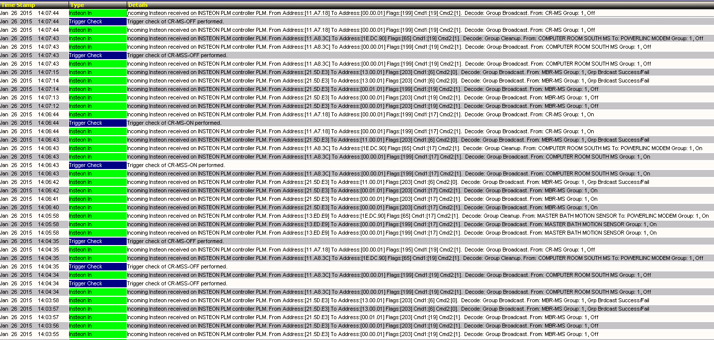

I moved an Access Point and now it appears PowerHome is seeing more of the messages. I can see that the first byte of the To Address of the Grp Brdcast Success/Fail messages seems to be the command code. I can't help but wonder if that should be used to help determine the state if the Grp On or Grp Off haven't been received? Here's my latest trace:
The triggers for MBR-MS aren't firing right now because they were disabled when the room got light from the sun. They will be enabled when the room gets dark.
Thanks to both Dave and Pete!

Posted: January 26 2015 at 18:29 | IP Logged
Tom,
Glad to hear you're getting more reliable comms. Just
so you know how to interpret the Broadcast
Succees/Fail message, here's a little info.
The To Address consists of 3 bytes. The first byte is
the command (in hex) that is being cleaned. The Off
command is 19 decimal, 13 hex so you know which
command the success/fail belongs to. The middle byte
is the number of devices that need to be sent
cleanups. I find it odd that it shows 0 as I would
expect it to show 1 for the PLM. Anyways, the third
byte is the group number. The Cmd2 is the number of
devices that failed the cleanup so a 0 is good.
Not sure how useful the info is. The main thing I
would look out for is getting a success/fail message
but NOT seeing the Group Broadcast message that should
have preceeded it.
