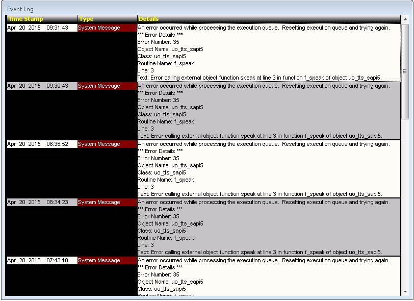

I'm beginning to see something called Error 35. I can't seem to narrow down what's causing it, but I know where in my app it's happening. It seems to be when I call a TTS from a specific macro. As far as I can tell, all the parameters are correct.
Can you tell me what Error 35 is so I can further narrow down what's causing it?
I did try reinstalling all the TTS externals, no joy.
FYI, I'm pretty sure this was happening BEFORE I moved to the RAM disk.

This would not be caused by the RAM disk. The error is
happening within the TTS call and doesnt have a
specific handler so falls back to the error capture in
the EXE queue processing.
Basically what is happening is that the TTS engine
that is currently active does not like the data that
is being passed to it. It may be odd characters or
something. It could also possibly be caused by calling
the TTS function while the TTS engine is currently
busy. I would try modifying the macro to log the text
being sent to the engine to see if that is the issue.
If there is nothing specifically wrong with the text
then its probably how the calls to the engine are
being made. Another thing you can try is changing the
TTS engine you're currently using. Different engines
handle the text differently and what may be an error
for one engine works fine with another. This would
just be a temporary test to try and rule out a
specific issue with the engine vs how the data is
being processed within the engine.
