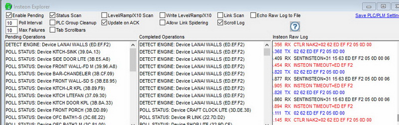

I just started to add several 2477D Insteon Dimmer Switch devices to Powerhome and have been complete buffaloed for a day now.
No matter what I do I can not get them to add to the Devices tab.
If I use *AutoDetect Device* I get NAKS returned, and the DETECT ENGINE keeps repeating until the Device is automatically Disabled for non-response.
If I try to determine the device type info using a ph_insteonwithret("LANAI WALLS", 16, 0) command I get a "-4" (NAK) error.
I have tried two different 2477D devices and have moved them to three different locations, one of them at the socket with the PLM so there should be no signal issues.
I Cleared and Added Min to the PLC/PLM Database to no effect, and have both reinitialized and restarted PH but all to no avail.
I have entered these devices many time before with no issues I recall. There have been no changes to my PH machine or software so really at a loss as to what is going on.
I even manually set in the Devices Tab the Device Type to a 2477D, checked the Use Ext for ALDB, tried checking and unchecking the Previous Exclude attribute, and tried I2 and I2CS settings to no avail. The I2 setting stops the endless Detect Engine effort but produces no results. The device never responds to PH control commands and returns Timeout errors in the Raw Log.
Everything else works absolutely fine throughout my house and I just successfully set up two keypads by connecting a cord to the same outlet I am now using to set up the 2477D.
Any thoughts? I think I have eliminated all variables with signals, connections, device definitions, etc.
I find it hard to believe I have just experienced 2 bad brand new 2477D devices.

Ken,
I see a couple of CTLR NAK2 messages which is a NAK
from the controller instead of from the device and a
couple of TIMEOUT's.
It's entirely possible that SmartHome has once again
made changes to the protocol if these are brand new
devices. I would try making a manual link first. Place
the 2477D in link mode and then press the button on
your PLM (or if you're using the stick PLM, go into
the "Manual Linking" tab and do the link controller as
a responder at the bottom).
Once you've got the initial manual link, see if the
rest starts working. If it does, then they probably
changed the mechanism for creating the first link
programmatically.
