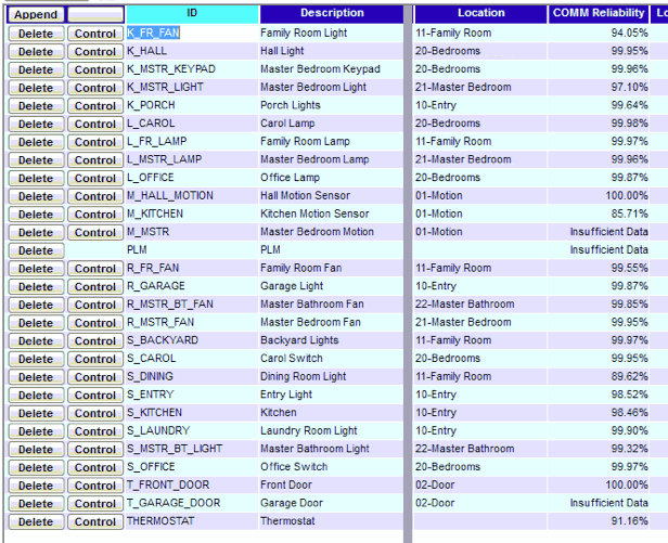

Looking at your screenshots, I would be curious what your Insteon Comms report looks like to help rule out any communication issues.

Posted: April 29 2011 at 12:34 | IP Logged Quote kev21986
Is this what you are looking for?

Posted: April 29 2011 at 13:25 | IP Logged Quote dhoward
Kevin,
Close, but I was referring to the "Overall Comm" report on the "Reports" tab. Judging from what you've posted though it looks like you've got some problem areas around the THERMOSTAT, S_DINING, M_KITCHEN, and maybe K_FR_FAN. The other stats look pretty good so I don't think you have a problem with your PLM or its location. Generally if the stats are low on all your devices, I suspect a problem with PLM location or interference. When its just a few devices, its most likely distance or interference in the area of the problem devices.

Thanks for look into this. I will move some things around and see if I can get
better comm reliability.
