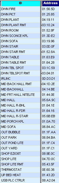

Insteon Parameters:
PLC = 08.A2.04
EZIO8T = 08.9E.0C
Light = 04.7D.0C
My Trigger event is . . .
My PLC/EZIO8T Links are set up as . . .
and the Insteon traffic I see upon Door Close (which is what my Trigger is trying to sense) is

Interesting question! I have no devices with address F7.17.9F.
As to linking... since I have no F7.17.9F I'm not linked to it. The EZIO8T and the (PLC and two lights) are linked as shown in my screen capture several posts above.

Neither the F7.17.9F nor the A5.3c.18 addresses exist in my Universe!
That is what has been throwing me in debugging this. I assumed that maybe they were Command bytes (rather than addresses) that I just didn't understand.
The strange thing is that the EZIO8T controls its associated lights OK, and faithfully reports its status back to PH as displayed in the Device Status window. These ghost address do not show up in the Bad ID, or Devices without Links reports either.
How all that can work, but a Trigger can't has this hombre very frustrated.

FYI here is a list of my Addresses:
