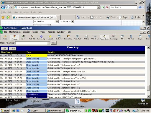

OK...I finally got around to figuring this out.
To figure out who armed/dis-armed your Elk system, set up a trigger using the generic controller as the "trigger type", the "trigger id" is the Elk controller. The trigger ID number is "Command 1" and the tigger Value is "Option1". Boolean field stays untouched as "1".
In my case, this trigger fires a macro. In the fired macro, [TEMP2]=the elk user number that was set up using ElkRP. [TEMP5] is a arm/disarm 4 digit value (1173 or 1174 for "area armed" or "area disarmed").
I am guessing that [TEMP4] is the area number (but since I have only 1 area set up I can't test this). [TEMP10] is the date and time that the trigger fired.
Hope this helps others...
See the uploaded log image.
