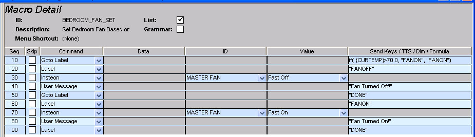

...and of course, I have a specific problem to deal with...this Macro is throwing a Syntax Error...can anyone see the obvious problem, because I sure don't - I've compared it to other macros in my line-up, and to examples on the board...

I should state that the Goto Label function with both results going to "FANON" is on purpose...either way, it runs through "FANOFF" - even in this case.

Unless there is some function in the Macro that is not working the way you want it to ignore the syntax error message in the event log. There is a known problem with the Insteon command for commands that do not have a cmd2 value (such as Fast On and Fast Off). PH2 is trying to validate cmd2 when no value can be specified.
No single step function that I know of.

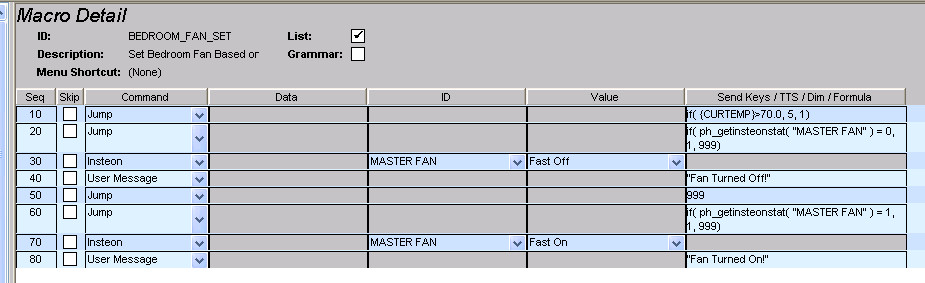

grif091 - THANK YOU SO MUCH! I was pulling my hair out on this one - the Macro WORKS....I changed it to use Jump Commands because I simply couldn't see the error and whether it was in the logic of the labels, gotos, formulas, etc. Here's what I have now and it seems to work fine:

FYI, labels themselves don't get quotes.

Tony found the problem with the Label/Goto Label. No quotes on the Label statement, quotes on the Goto Label string.
Label/Goto Label tends to be a better approach in most Macros because they are not affected by changes to the Macro over time the way Jump line numbers are.
Sorry I missed the quotes on the Label statements.

TonyNo and Grif - Thanks again - I didn't find anything about whether quotes around labels were required...I'd seen macros both ways...this is very valuable information.

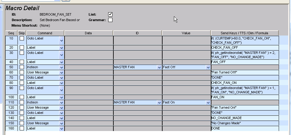

Ok, one last posting - based on the information you two provided (for which I am EXTREMELY THANKFUL), I re-built the macro like this, with some messaging so I can see the status changing along the way:
