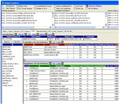

Here are screen shots of how I have set up my group and links for the KPL indicators
Group Link
These two files (trigger macrojust save these on you system) can be imported into PH to create the Macro and Trigger I use. Obviously they won't work on your system, but you can look at how they are put together. I am no where near expert on this stuff and I'm sure there is a better way to do it than the way I have.
