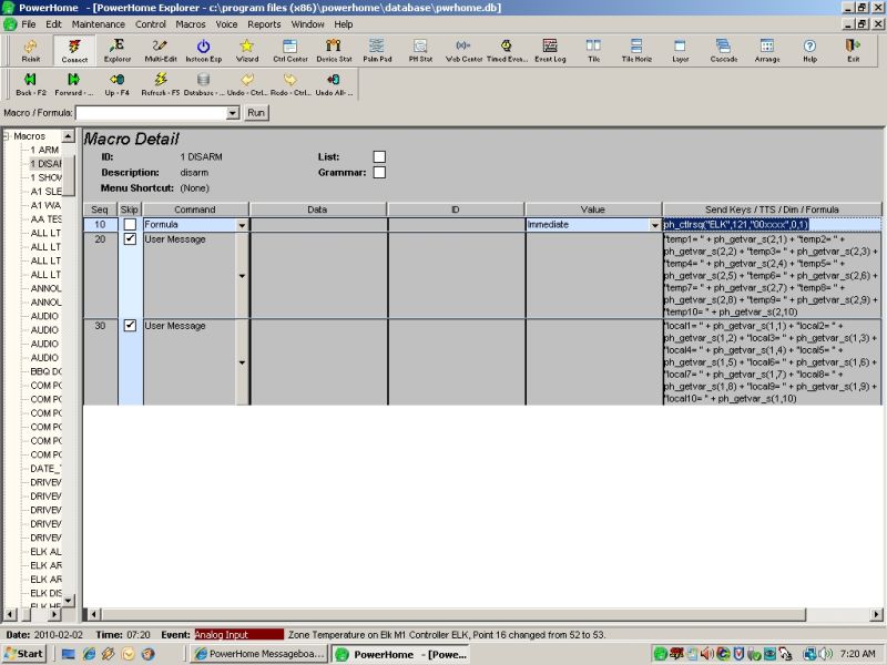

Arm and dis-arm macros:
Edited by smarty - February 02 2010 at 08:25
