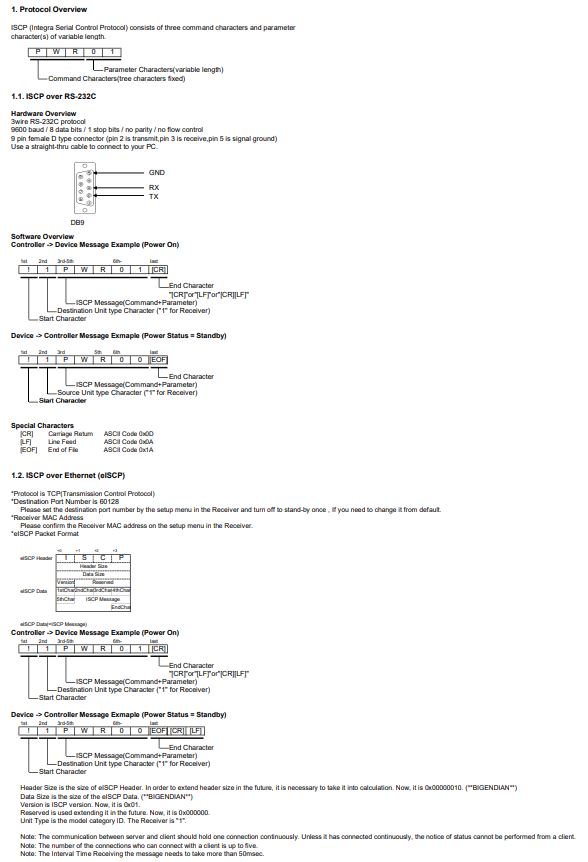

The Onkyo reciever eISCP ("e"thernet Integrated Serial
Control Protocal) messaging is slightly different than
the direct serial protocal messaging (ISCP).
Onkyo protocal documentation is attached here:
From my web searching and testing with the "Packet
Sender" utility (found here: https://packetsender.com/
), I can make my Onkyo receiver turn on/off, change
volume, mute etc....
The Packet Sender strings look like:(in ASCII)
PowerOn:ISCP\00\00\00\10\00\00\00\08\01\00\00\00!1PWR0
1\r

I have tried most every variation that I can guess at:
ph_picmd(2,"ONKYO_SOCKET",1,0,0,"ISCP0000000000000000~
n","")
My question likely centers around how the plugin
handles (or doesn't handle) special characters. I
also have some uncertainty with respect to 8th and
12th characters from the left (has to do with Onkyo's
protocal and data field sizes). Not being a computer
engineer/scientist, I am a bit at a disadvanged here.
