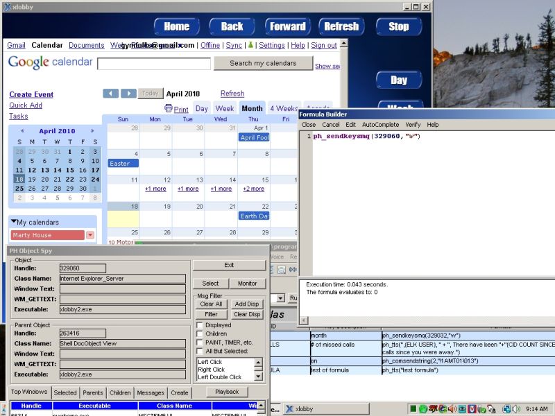

I have used the "Window Spy" a fair amount in the recent past for locating window handles and then sending keys to the found handle....that is how I control my Geovision Camera system.
See the attached picture.
You can see that "Window Spy" says that that the Google Calendar window is 329060 (the mouse WAS over the calendar area...just not showing in the pict). You can also see that I was trying to send that handle a sendkeys for a "w" (the week view"). It did not work, the view did not change.
When I try this same experiemnt outside of Xlobby (in other words I just open up a browser window and navigate to Google Calendar), I can find the proper window in the same manner, and here, the sendkeys does work.
Therefore, I am thinking the key issue may be when I "embed" the IE Google Calendar window into Xlobby, something happens there.
Joined: May 21 2006 Location: United States
| Posted: April 18 2010 at 10:41 | IP Logged
See this picture...
When I send keys to the Xlobby window that surrounds the
"embeded" calendar (mouse WAS over the Xlobby blue colored region), there is still no effect.
Note what is displayed in the Window Spy box....some sort of 'handle wrapper'????
