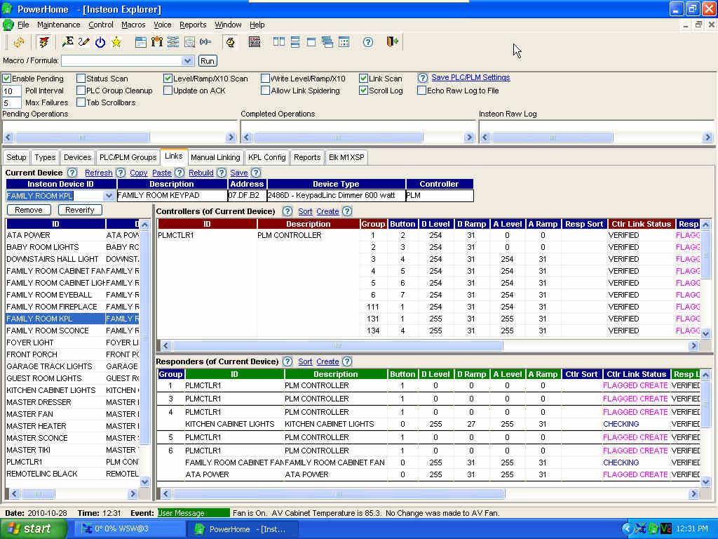

 Ok...the backstory:  Originally, this was a 6-button KPL 600-watt dimmer...it is relatively old, but comes up as v41 firmware...I changed it to 40 in PH and before my most recent change that *helped* PH to see it (not perfectly).
 I recently changed it from a 6-button to an 8-button and this is where the real trouble started...
 Numerous problems including it will not link to anything at all (although acts like it should).  Also, PH seems to have a very difficult time communicating with it (A lot of "INSTEON TIMEOUT" red messages in the Insteon Explorer Status).
 Here's the REALLY weird one:  The "load" button for this thing should be the top-left button, right?  Well, it does nothing.  Better yet, the light attached to the load circuit works FLAWLESSLY with PH (I can do anything to it with macros, device control in Insteon Explorer, or Device Status Window - no problem and instant).  There is NO plug-in module for the light...it is in fact plugged into the wall and enclosed in an "Outlet Protector" to keep my 1.5-year-old son safe....so wow....who's got some ideas on how I can test/diagnose this thing to see what's going on...?

          Hi Grif...I've double-tapped upper-left and still nothing with the load light (although I still have full control via PH).
           | Posted: October 28 2010 at 13:48 | IP Logged |   |
 Plot thickens - One of the buttons I was able to successfully and reliably link to a light elsewhere in the house.
 I did a factory reset on this thing, then made it 8-button.  Is it something in the mapping, or possibly some interference in the Insteon Network that wasn't there before?
 I also changed from a PLC to a PLM...

 1)  Yep, all the LEDs light and unlight when toggled on these buttons.
 2)  I used the KPL buttons to set 8-button mode.  I can't even bring this up in PH for KeypadLinc config.  Grrrr.  Here's a screen shot...I know there's a lot of "Pending" - that's due to the non-communication to the KPL (I think)....go ahead and let me know if you see something obvious though...
 -S

          After a Factory reset and using the KPL buttons to set to 8 button mode, if the upper left Main-A button does not turn On/Off the load the KPL is defective.  Normally one thinks about wiring and type of load connected to the KPL but if the KPL load turns On/Off using Direct commands from PH2 then wiring and load no longer seem to be in question.  If PH2 set the 8 button mode then I would think memory mapping since we already know that you had to misidentify the firmware revision but with nothing involving PH2 as far as setup goes I think the KPL is bad.

 Going back to some basic questions because I think the act of changing from from the PLC to the PLM and copying all of the links over, making subtle changes to get it to work may have somehow clobbered me in general.
 MY BASIC REQUIREMENTS:
 1)  I need to be able to intercept KPL commands in PH so I can execute macros for sophisticated scenes, etc.
 2)  I need to be able to set the KPL lights for the individual buttons from PH.
 3)  I need to have *some* direct links from the KPL to various Insteon devices (this, at least seems to work when I use the KPL and the Insteon device to make the link - not sure about whether doing it in PH has the same affect).
 So some basic questions:
 1)  How does the concept of "Insteon Groups" work with regard to a KPL?  Originally (somehow) the first button on the KPL was 131, and so-on through the 6-button config (when I had it setup as a 6-button KPL).  There are remnants of that in my links today.  When I went in and setup the links/groups for this thing, they were 1, 2, 3, 4, ...8 - somehow I suspect this is terribly wrong.
 2)  Is there an article out there from scratch on how to set one of these up in PH, with the basic links, etc.?
 I am so dumbfounded by this right now I think I should leave it at that until I get to the next step.  Wow, these things are more complicated than they should be.

          All Insteon devices (setting aside PLC/PLM as that is software controlled) issue an Insteon Group sequence when a paddle/button/sensor changes state.  That is a paddle/button is pressed or the voltage applied to a Sensor changes state.
           | Posted: October 30 2010 at 19:16 | IP Logged |   |
 Devices such as SwitchLincs and ICON switches all use Group 1 when the paddle is pressed.  Of course the Insteon command varies based on top or bottom paddle, how many times pressed and if the paddle is held.
 All Insteon KPLs in 8 button mode use Group 1 through Group 8 representing the buttons in sequential order from left to right, top to bottom.   Main-A uses Group 1, button B uses Group 2, button C uses Group 3, and so on.
 All Insteon KPLs in 6 button mode use Group 1, 3, 4, 5, 6.  The large ON and OFF buttons use Group 1.  The first small button (labeled A in 6 button mode) uses Group 3, the next small button (Labeled B) uses Group 4, and so on.  The small buttons in 6 button mode use the same Group numbers as those buttons use when the KPL is in 8 button mode.
 For ANY Insteon device (again ignoring PLC/PLM) to send a Group message there must be a link in the sending Insteon device (considered the Controller) and the receiving Insteon device (considered the Responder).
 For a KPL button to send a Group message (which is all it knows) to the PLM so that PH will see the message and initiate a Trigger, the KPL must have a Controller link record with the Group number representing the button pressed and the PLM must have a Responder link record with that same Group number.  Same would be true for a SwitchLinc to be able to initiate a Trigger in PH.
 For PH to turn ON and OFF a KPL button requires a link in the opposite direction.  The PLM is the Controller in this situation and the Group number is your choice from 1 to 254.  The KPL requires a Responder link with that same Group number.  The Primary KPL button (Main-A in 8 button mode and ON/OFF in 6 button mode can be turned ON and OFF with Insteon Direct command (as apposes to Group commands).  Only the Primary KPL button, the one that directly controls the load attacked to the KPL, can be manipulated with Insteon Direct commands.  Insteon Direct commands do not require and do not use link records.

 Pete, Mark and Lee....you'll get a kick out of this...the "load" (what we THOUGHT was Group A) didn't control the light I thought it did....so it's not as screwy as I originally indicated.  My blunder.
 Thanks again Gang,
