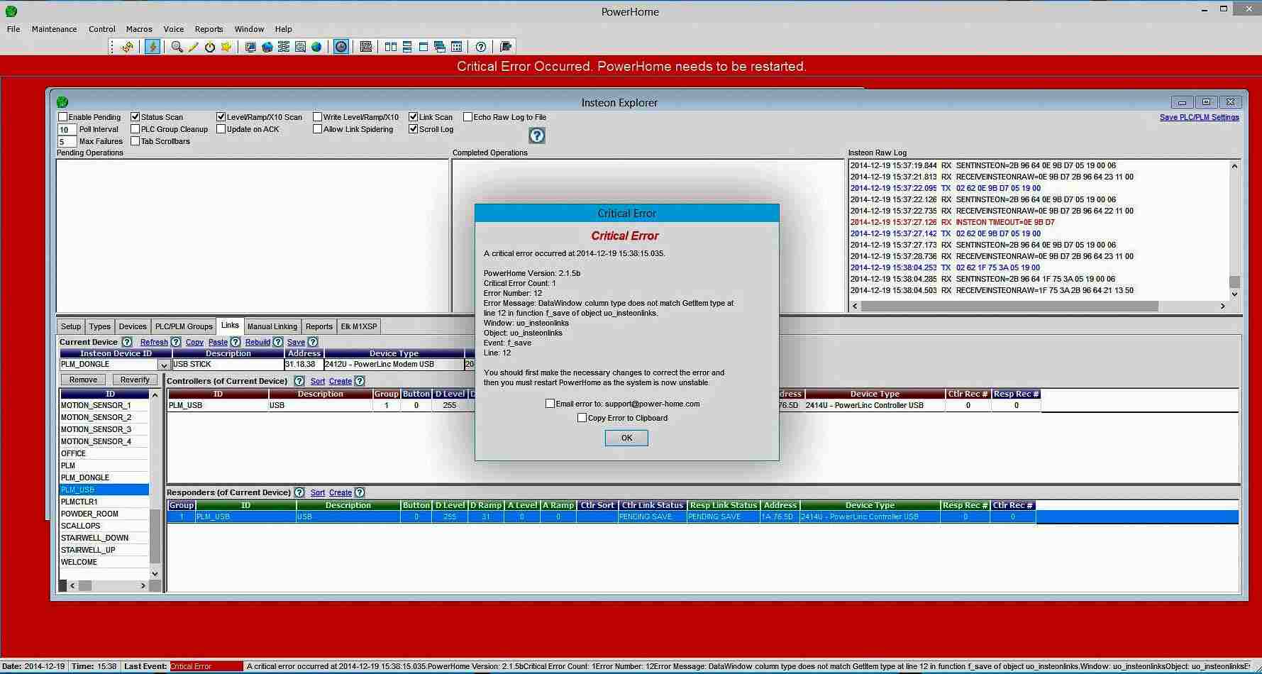

Posted: December 19 2014 at 13:08 | IP Logged Quote smarty
Just upgraded to 2.1.5.b
Seemed to go pretty well.
I did notice that upon PH startup, my initial PH window was not full screen and the PH Explorer was only part "windowed" (I like to have it open and "full screened").
So, I started to change a few settings in the pwrhome.ini file and ended up with this error (see image file).
Any ideas on what to change in the .ini file for full screen Powerhome and full screen PH explorer?
I have also attached my .ini file (changed it to a .txt file and scrubbed for security).
Thanks in advance.2014-12-19_130724_pwrhome.txt

Posted: December 19 2014 at 13:27 | IP Logged Quote dhoward
Steve,
Not sure what could have caused that error. I'll take your INI file though and see if I can reproduce.
You shouldnt have to edit your INI file directly though for these settings. From within PowerHome, just open the windows and position/size and set state the way you like. When you close PowerHome, it will automatically update the INI so that at next launch the windows will open in their previous state. Note: you can only have PowerHome remember to open a single window on startup. If you want to have multiple windows open on startup, you can use the ph_openphwin function in the startup trigger.
Just to get you going, I would copy over your pwrhome.ini file from your renamed directory and launch PowerHome. It should startup without issue. Then just set the windows the way you like within PowerHome, close PowerHome, and reopen and see if they remember the state or not.
I'll load up your INI file and see if I can pinpoint and fix the error to prevent it from happening in the future.

Posted: December 19 2014 at 16:55 | IP Logged Quote smarty
dhoward wrote:
Steve,
I did copy over the prior .ini file ...I have not seen the error again (can't reproduce it). After sizing the PH windows and then closing/exiting PH, upon the restart, the PH windows did not come back as desired.

I generated another instance of BeachBum's critical error, exactly same message but with a different fact pattern. Conversion to 2.15b was uneventful. After an hour or so a decided to address a previously identified linking problem with a Insteon-mediated 4-way switch linking structure. Looking at the links for the switch controlling the actual circuit a noticed some '[ID Not Found]' lines in the links. I have some in these my large database for some reason and they have never seemed to be a problem but I decided to remove them by dragging them to the the left. 2.15b immediately crashed with the error message noted above. I repeated the process with a fresh copy of the program and database with the identical result.
I went back to the 2.15a DB and program and tried to remove the [ID Not Found] lines and 2.15a removed them with no difficulty. I went through the nearly 100 Insteon devices in my DB and removed every instance of [ID Not Found] and switched to 2.15b and it has been running without incident.
As the DB is version compatible, I suggest users retain 2.15a for at least this type of database maintenance until this problem is figured out. Otherwise 2.15b is terrific. PH just gets better and better.

Posted: December 19 2014 at 20:50 | IP Logged Quote dhoward
Steve,
Ive tried to reproduce your critical error and have been unable to. Ive been using the INI file you attached with only a slight change to the database location and cannot reproduce the critical.
However, I can reproduce the PH Explorer window not opening/staying at maximized. This is an error that got introduced as a result of a user requested mod to have the title of the window reflect the actual screen that is opened in the PH Explorer. It won't happen with any of the other windows, just the PH Explorer. It took me awhile to come up with a fix but I have it working now. There is an annoying flicker as you change detail windows within the Explorer and unfortunately, I cant get rid of it. The flicker is really only evident in the maximized mode but the desired operation of opening maximized (and staying that way) is now working.
It'll be out in 2.1.5c (a bug fix to be released in the next few days).
Posted: December 19 2014 at 20:53 | IP Logged Quote dhoward
Pete,
You've encountered a major bug I introduced in this version. It looks like the link screen will be down until I release 2.1.5c in a few days.
Ive already located the issue and corrected it.
Appreciate the testing.

Terry,
Appreciate the feedback. Definitely a bug that I introduced and is now fixed. We'll see 2.1.5c early next week with the fix.
