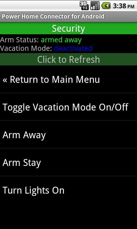

Hello, everyone. I wanted to let you all know that I am developing an Android app to
connect to and control your PowerHome installation. It will be completely
configurable by the end user to add as many Pages as needed, and each page can have
as many actions as desired. You will also be able to display status strings as shown
here. The status can be updated manually by tapping the "Refresh" link, or it can be
updated manually, in the background using the Android C2DM service (you must be
running Android 2.2 or later to use the C2DM service).
I hope to have it available in the Android Market within the next week or two. I hope
that some of you will find it useful.

Well, I am just about done with my PowerHome app for Android. I would like to have one or two people try it out so
I can have some confidence that it works. To get the most from the app, you must be running Android 2.2 (Froyo) or
higher. Here is a page I threw together with instructions for generating your xml configuration file.
http://skipstechtalk.net/powerhome-connector-for-android/
I go into a lot of detail on that page, so it sounds harder than it is.
If anyone here wants to give it a try, let me know. I will email you a link to the .apk file and you can install
it manually. If it goes well, I will push it to the Android market.
For now the app is free, but I am considering charging less than $10 for the C2DM push messaging since I do have
server costs to defray.
Skip
