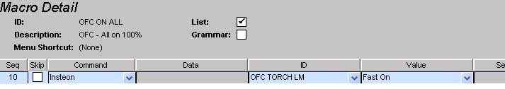

I'm having some trouble figuring out the proper commands and syntax of things to get this to happen: I have two lights in my office, only one of which is controlled by the wall switch, so I want to have a trigger that says "if the switch is turned on after 4pm, turn on the second light".
In trying to do all of this, I have tried several things but just can't seem to get it working. Here is the Trigger I set up:
Action Type: Raw Formula
Action: if (hour(now())>16,ph_macro('ofc on all'),0)
Type: Insteon Direct in (ACK) - also tried without ACK
Trigger ID: Wall Sw
ID Number: From Any (tried several others as well)
Trigger Value: Fast On (tried also just ON)
The formula seems to work fine when I test it, but I can't get it to trigger from the light switch.
Any recommendations?
